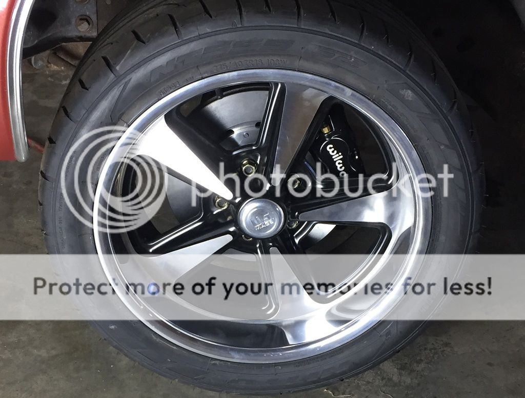

willwood kit 140-12022

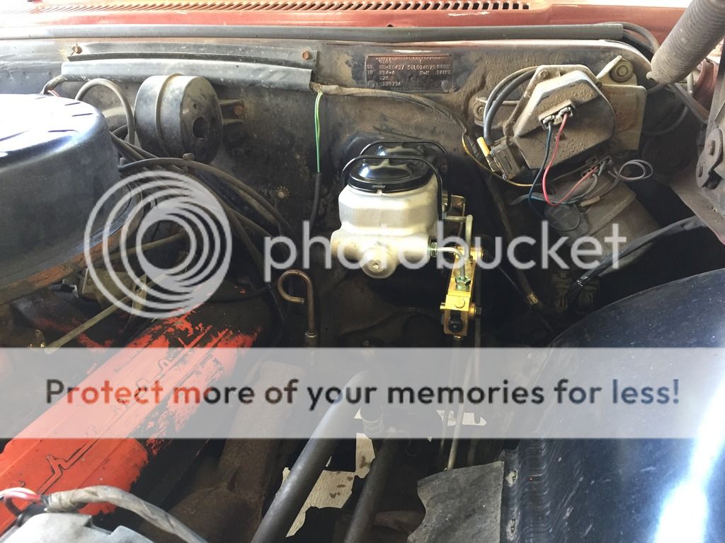

Just wanted to report. I did finally order and install this Front brake kit. This is a wonderful way to convert from drum to disk brakes on one of these cars. All of the components are super high quality. I am extreamly happy with the results.
In the process I also converted from power assist to manual which removed the brake booster from the firewall. This was another home run and works great with this Wilwood kit.
66 impala,283 power glide, Aztec bronze

Normally the master cylinder diameter is a different size when you go from power to manual or the other way around. If it seems like you need a ton of pressure to stop I would look at updating the MC.

yes, I did change the master cylinder

I talked to wilwood a couple of times before I bought this kit. I had all my ducks an row when I called and they basically told me "yes, that should work" on two different subjects on both phone calls. Great company and great products

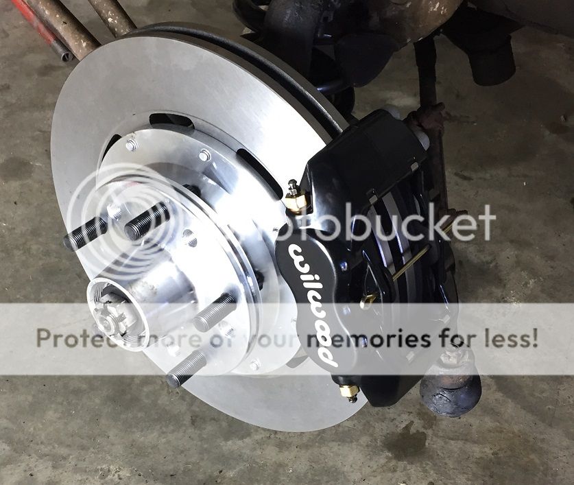

The kit
Caliper mounting bracket installed
Hubs assembled
Rotors installed
Calipers installed
Wheel installed (there is a slight rubbing with the weights. Instead of getting a spacer, I think I will see if a shop can rebalance and put the weights somewhere else.

We still need to run the proportioning valve and the lines, then bleed the brakes. But I am very happy with how the kit came together. I just wish that they did not use torx bolts for almost everything. I hate those things.
