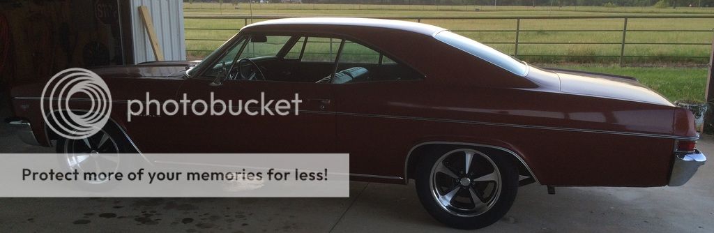

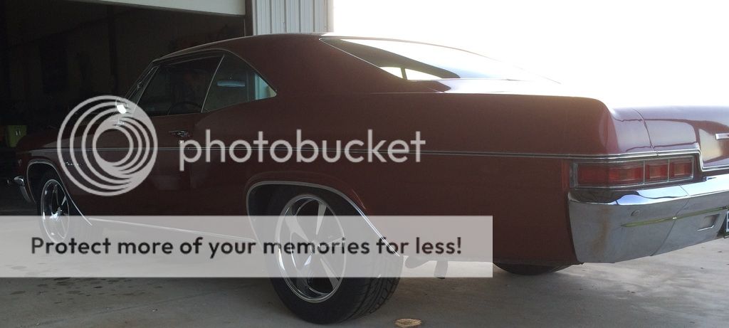

Talking new wheels and tires ! 18's it is...

Those look good on there, are you gonna lower it at all?

Thank you ! I am thinking I might lower the front a little more. I just put s10 springs in the front thinking it would lower it some but it only came down 1/2"
