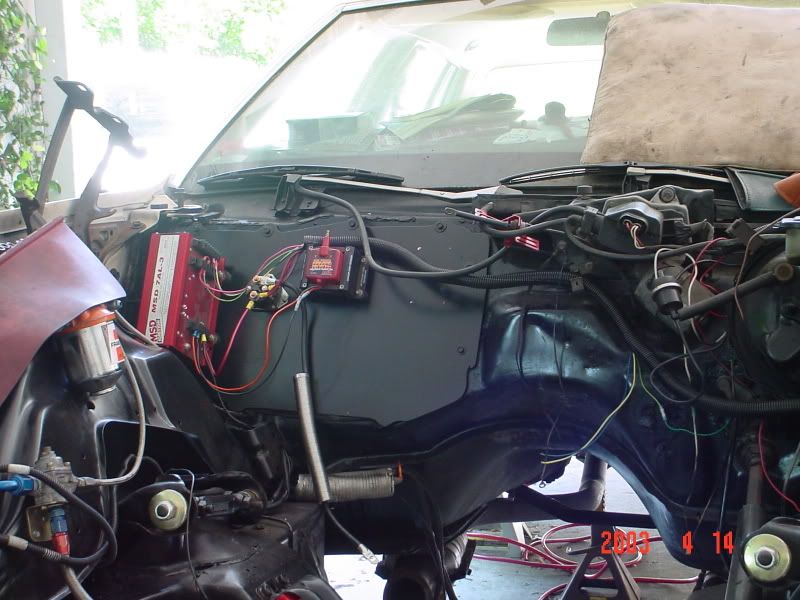

There are no block off A/C delete plates there is only a heater only plenum on cars that did not come with A/C. I had to use an aluminum speed limit sign to cover the hole in the fire wall on my Impala.
