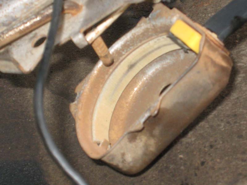

This is what the inside of my bad sender looked like. The light band inside the metal cover is actually wound with wire. You can see the area where the wiper rubs on the wire. The wire can get rust and/or break causing bad readings. Also the floats can develop leaks which also cause problems. They do make a stainless steel version, although I don't know if it is any better in terms of wiper corrosion.
