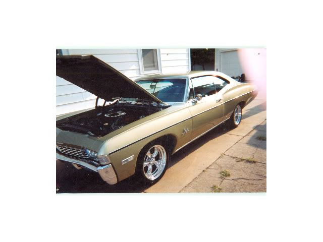

Here is what it looked like before I tore it down.
1966 Caprice
1968 Impala (Frame Off Project)
2001 Tahoe LT
1972 Chevy C10
