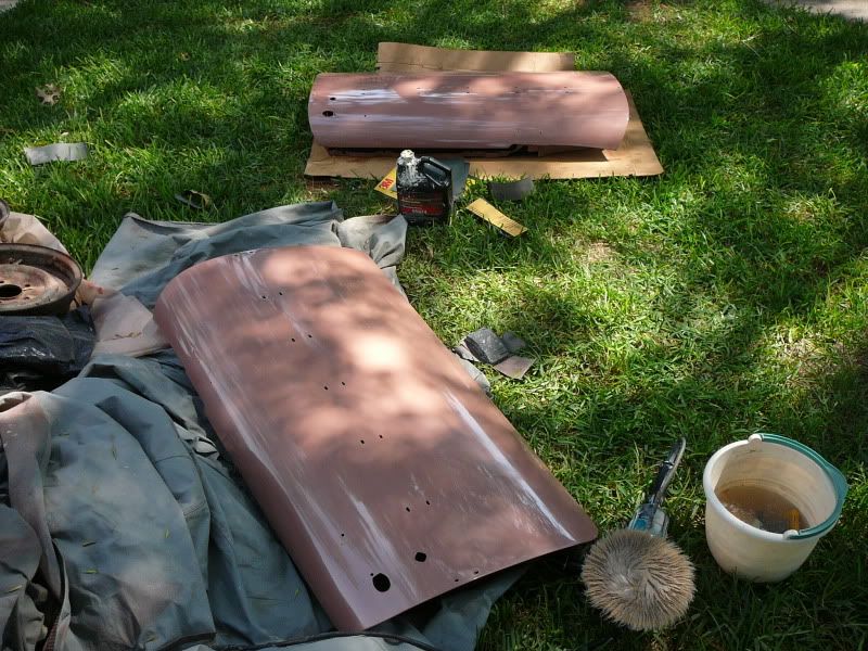

today we sprayed the dash.... We had it painted at one time, but some rust formed, so we had to strip half of it, treat the rust, and start over. we painted the entire dash today with 4 coats, put 4 more coats on the steering wheel, and touched up one spot on an interior trim piece that was a little thin. The good news is after all of that we STILL had a little paint left over. About 6 oz, already thinned. Does anybody know what the shelf life is for thinned paint?
We also prepped the body for first coat of dupont. It's sanded down with 400 straight as a whistle. We're going to paint one coat on Saturday morning, let it dry, and then prep the body for the final coat. These last two coats we're really obsessing about how perfect the body is before we put on any paint. I can go over the entire body with dry 400 and not see any ridges or anything that resembles uneven spots, so I'm confident we're ready to go. Normally we wouldn paint two coats in one day, but as important as that top coat is going to be,I dont want to rush the prep job for it, or spray when it's too hot outside.
Still hoping to done painting by the end of the month, and then we're going to put the gas tank, fuel lines, and engine in the car
