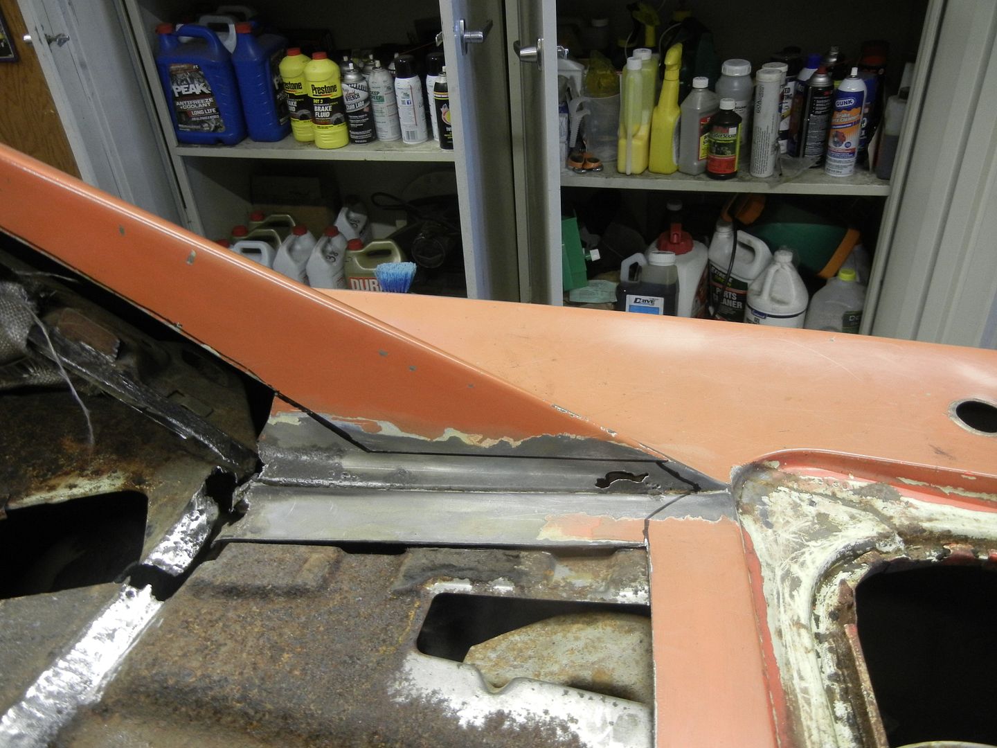

Don't feel alone, Jayhawk, I jinxed myself too. I removed the rear window trim on my Chev-elle and opened Pandora's box.
It looked half-way decent with the trim on. I had to PRY the trim off, as it was mostly held on with sealant.
I found the previous "repairs" under the sealer...pop riveted aluminum patches, tin foil and masking tape to hold the bondo until it set...:sad:
Made the first cut.

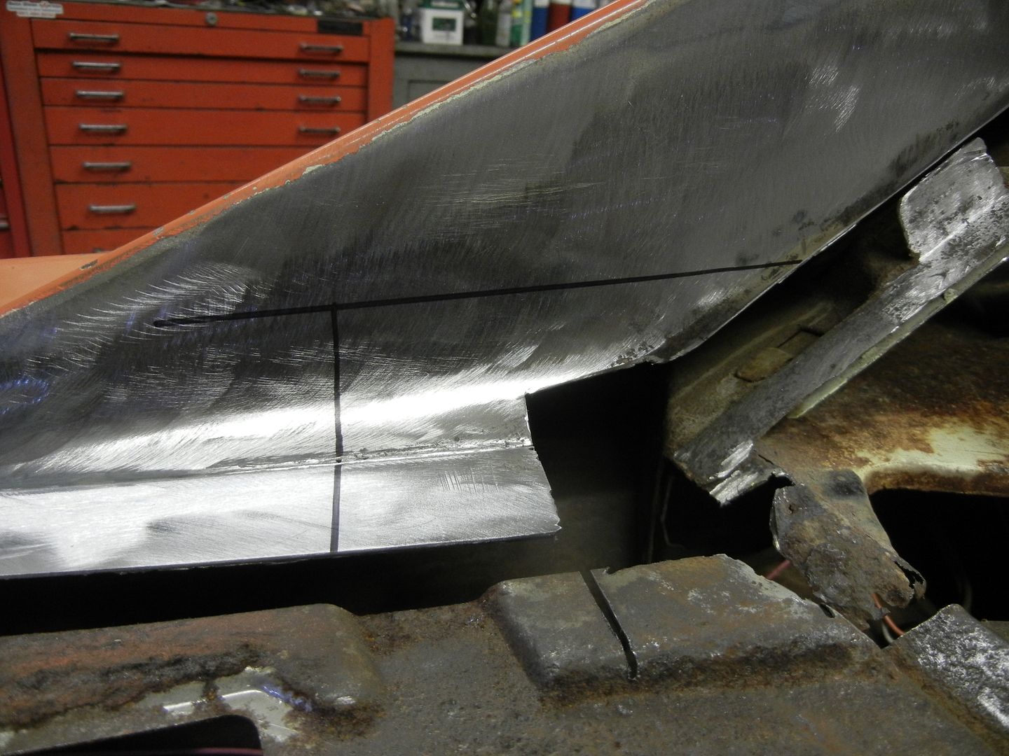

Spent some "quality" time with the Chevelle today. I removed the remnant of the extension skin and found more rust than I hoped for...:rolleyes:
THERE, I fixed it...don't I wish...:(
Started cutting out the cove damage.

That's what sand blasters, rust treatments, and undercoatings are for, that go underneath the new skin.:D
Good luck, keep us posted.
The tool on the right in the second pic scrapes off the loose scale and then it will get converter and epoxy sealer...:thumbsup:

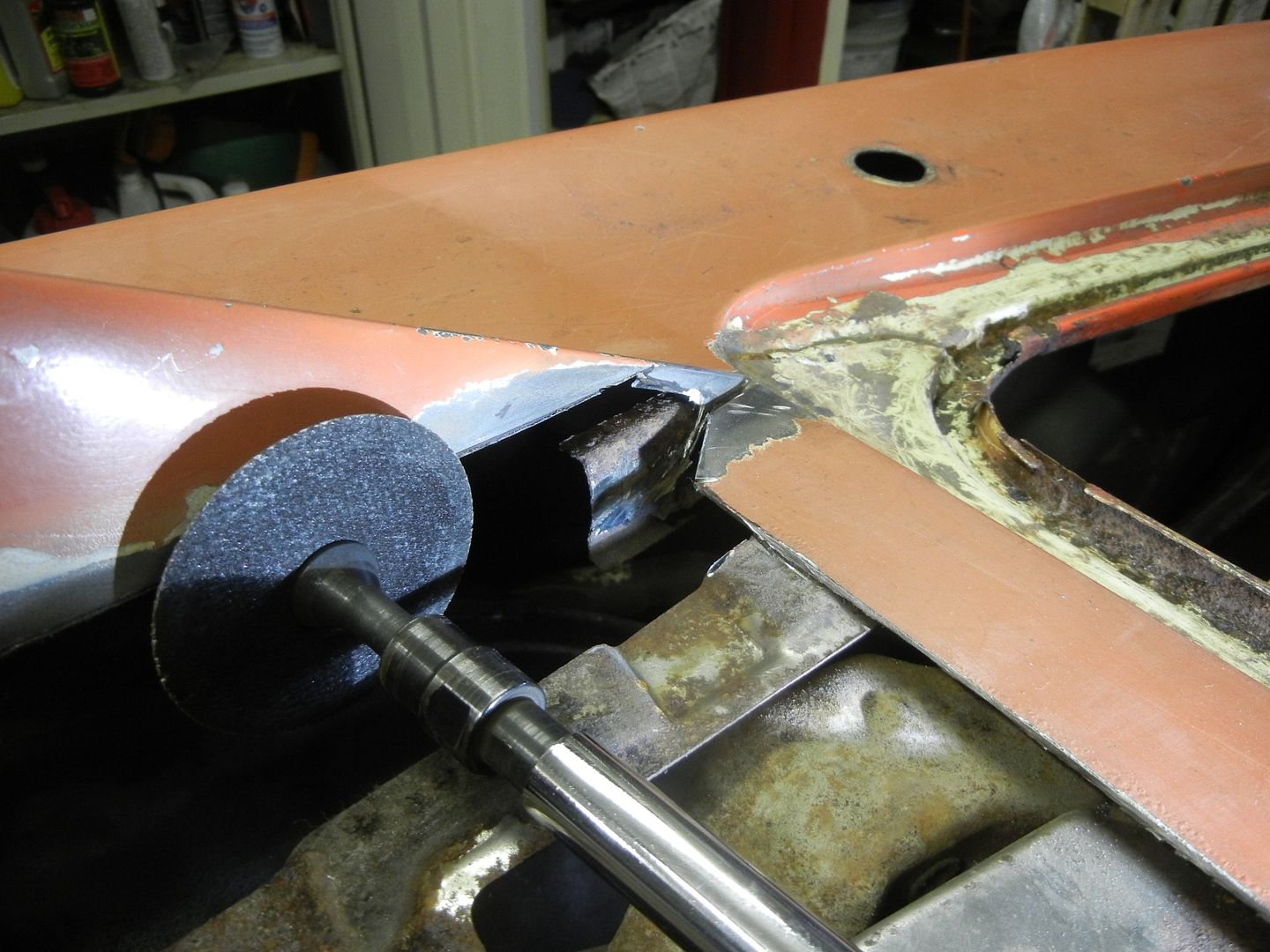

Today, I cut out the rust on the right side. It was worse than the left and there's rust damage in the upper radius.
But wait, there was no inner flange under the cove panel. It is misplaced inboard by 1/2" !! There were no spot welds to grind out because the flanges aren't even close.
Oh well, I'll deal with the mis-alignment later. I ground out the rust in the radius, made a patch and welded it in. First repair complete...
