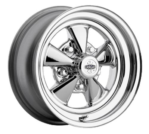

My goal would be to keep the suspension comfortable, but not so ‘floaty’. In the distant past, I upgraded to a thicker anti-sway bar in the front and added one to the rear. I will be using a Cragar SS type wheels and the widest tires I can get away with (wish I could remember what size I used back then).
I want it looking like I had it in this old picture
